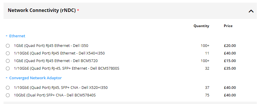

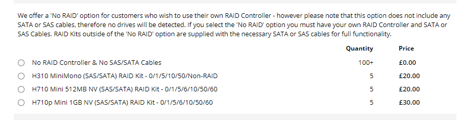

jfr2006 Posted March 13, 2024 Author #6 Posted March 13, 2024 OK, just found a possible solution: a Dell Poweredge R720xd with 12 3.5 drive bays. The price is good, i can use the ram from the R320, the processor can be a Intel Xeon E5-2630 V2 (same TDP as the one in my R320, but more cores and more processing power). My doubts: Will the Perc H710 mini be supported by ARLP without any extra trouble? And which network cards will be better supported? Quote
jfr2006 Posted March 13, 2024 Author #7 Posted March 13, 2024 OK.. Answering myself: I decided to try xpenology on my Dell R320 which has the Dell BCM5720 network card and the Perc H710 mini controller. The network card is supported. Has for the controller card, i already found out it must be flashed to IT mode. I will do it on the 720xd. Going to order one tomorrow. Regards. Quote
