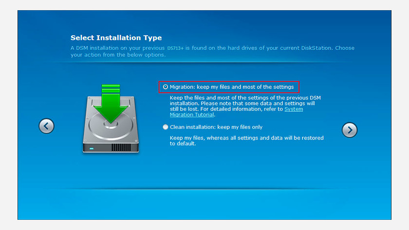

Hey! In xpenology I have 2 disks (4TB and 500GB) and RAID0 (4TB + 500GB). Decided to update from DSM 6.1.7-15284 with jun's loader to 7.1 with ARPL. Successfully updated and founded that RAID0 become unavailable, but it was still existed in storage manager. Seeing this with horror, I decided to roll back (my bad) to 6.1.7-15284. I changed USB stick, booted up with 6.1.7-15284, xpenology suggested a migration or reinstall (screenshot). Migration was unsuccessful because I had to download a version higher than the current one, 7.1. I selected reinstall option (there was a text that the data will remain unchanged after reinstall).
