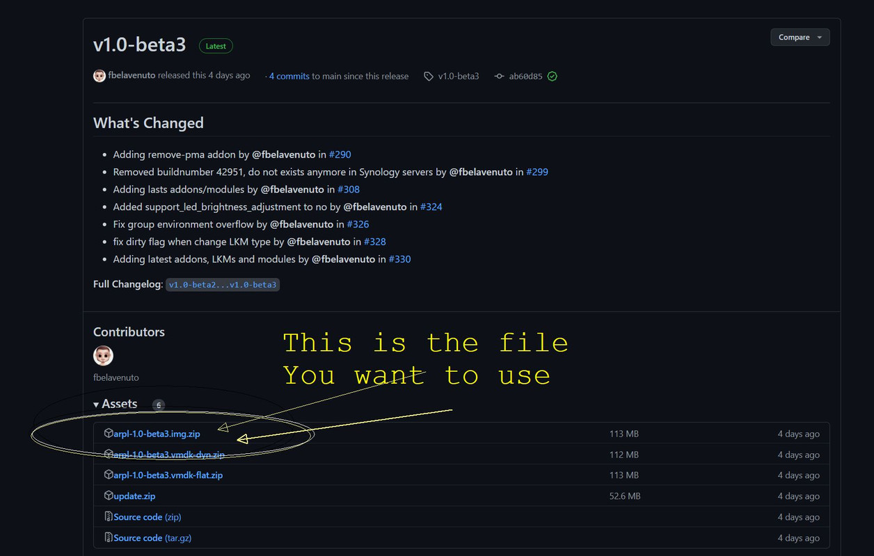

Does someone have a guide for spinning this up on esxi??
Ive been trying for several hours using the arpl flat files and converting using vmkfstools and whenever i try to add the converted file it never reads any size on the volume or allows me to allocate it to a controller.
Im sure it shouldnt be this difficult. if someone could provide a link for a working converted vmdk or a guide to the process it would be appreciated.
