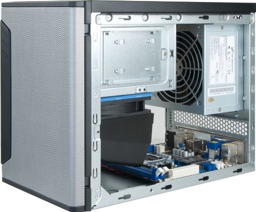

It may actually be running too hot. My server case is my favorite 4 bay server case out there as besides the 4 bays it has a place on each side for the ssds. Problem is it has one fan that blows on the hard drive cage but it's not getting air from outside the case. It's a Chenbro SR30169 server case. Been real tempted to have a hole cut in the top and add an exhaust fan.

Hm... just a basic idea: you could use a dual ssd mounting cage. They usually have bore holes at the bottom. Then you can mount both SSDs in it and place it directly behind the perforated front plate. They would „sit“ in the air stream of the hdd cage fan. Something like in the sample picture.
Edited by jensmander
  • 0
I will give that a try before I decide to mangle my case. I didn't realize heat was ever a problem with ssd's. Thought that was only a spinning hard drive problem.
