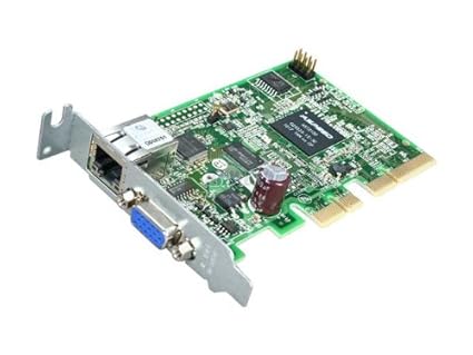

@sebelec The only reason to cut it, is to install the X4 card in an PCIe-X1 slot (with a "closed" slot), if you look at this pic of the main, you can see the X16 slot at the bottom,
with the standard X1 slot just over it, just to the left of the X1, is a non-standard positioned X4 slot, for a RemoteAccessCard (RAC).
If you look at the HP N360T, parts of it connector will "crash" if you place it in the X1 slot., so it will have to be cut to fit there. Without the extra slot behind, you could just cut the plastic
of the slot, making it an "open-ended slot", that allows you to place longer cards inside a smnaller slot.

@d0nIf you study the layout of the slots, you will see that it's physically impossible to use both slots at the same time, with 2 cards, unless you use a flexible riser solution.
Even then, I'm not sure if it can be done. Actually the RAC are using both at once, but that's a propritary card, so non-standard.
